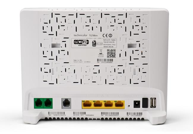

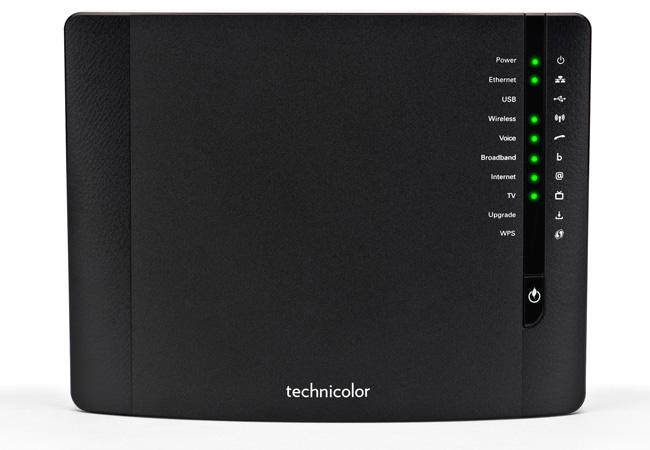

Technicolor TG788vn
  • Integrated VDSL2 modem
  • 4 Fast Ethernet (FE) ports to connect multiple devices, such as PCs, laptops, set-top boxes...
  • Wireless networking on-board: 802.11b/g/n (2.4 GHz)
  • Wi-Fi Protected Setup (WPS)
  • 2 FXS ports
  • Media sharing: UPnP A/V and DLNA
  • 1 USB 2.0 master for hard disk, printer, 3G adapter ...
  • Remotely manageable: TR-069, TR-098, TR-104, TR-111
  • Built-in stateful firewall, parental control
  • Innovative easy-customizable design
  • Future proof hardware and software
  • IPv6 ready
  • ECO COCv4 compliant
