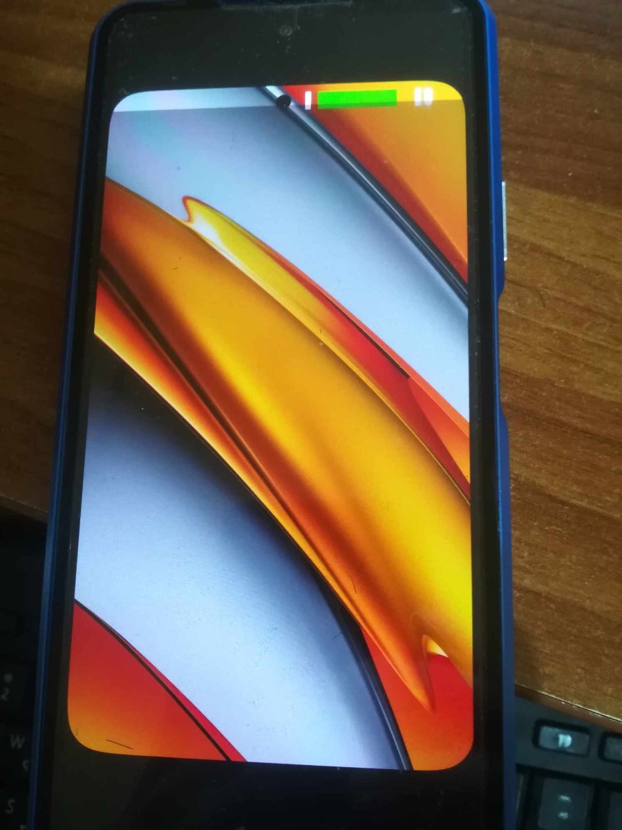

Hello. I was using some resolution changer app (https://play.google.com/store/apps/details?id=com.draco.resolutionchanger&hl=en_US) to my Poco F3 to change resolution so that in mirroring in my TV to be in Full screen. In the latest time, I wrote by mistake the 1920 as value in the resolution & in DPI field instead only to resolution & I apllied it (default values is 440 in DPI). Then the mobile's screen was frozen and after restarting (this value is NOT reverted automatically to default value after rebooting) either will stuck in logo of of MIUI and it will be in bootloop mode either will boot in normal mode if I make safe-mode from default recovery (no custom recovery) which has it as option but it appears only homescreen without any app (due to high value of DPI - density) and can't do anything.

1st Printscreen (it can boot ONLY in Safe Mode & appear as enlarge a small piece of normal hmescreen)

Futhermore, except from build.prop file, I have read that in /data/system/users/0 exist the settings_global.xml file in which you can edit & change the "display_size_forced" (for resolution) and also in settings_secure.xml, you can edit & change the "display_density_forced" (for DPI). In first file, I can find the "display_size_forced" & if I change its value then the resolution chnages (it works!) but in second file doesn't exist the "display_density_forced" to change it (also I tried it to add it manually without any result. For this case I mind the below & I don't know if it will be correct or not. My default resolution is 1080x2400 with DPI 440 but the current resolution is 1080x1920 with DPI 1920 while I have found only way to change the resolution. Also if I flash the default recovery (No Twrp) then via Safe Mode (I don't know if it exists and as ADB command the Safe Mode) I can boot to normal boot (printscreen) but not any app is appeared because is very enlarge (440 DPI -> 1920 DPI). If I enlarge accordingly and the resolution so that to keep the default ratio between Resoluion/DPI then can the homescreen to NOT be enlarge (it may have a very small icons due to high resolution) as result to install again the Resolution Changer & at this time to put the corrects values or I will mess up worse my mobile ? I forgot to say that via TWRP I have unistalled the esolution Changer with its data but didn't fix the problem. Also, may anyone know which system file is that which keep the DPI so that to change it ?

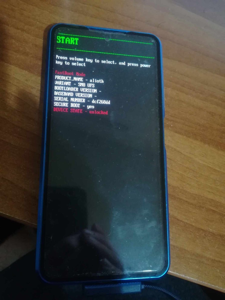

  1. The last method which I have tried, is to make dirty flash rom but didn't fix the issue. 2-3 times my flashing didn't completed sucessfully by apearing errors like "error flash timeout 1424" (due to getting over 700 secs) or "flash super error - FAILED..." as result to boot only in fastboot mode (2nd printscreen) but furtunately I managed to make is via new flashing it was before (with operational boatloader & recovery but with bootloop in normal boot). I tried and the TWRP Rom flashing & via "MiFlash20220507" but none of them fixed the issue of DPI. I have read from other similar situation that if I make clean flash then it will fix the problem. But what is the different between dirty & clean flash ? According with *.bat file the clean flash except from locking boatloader, it wipes the userdata partiton. May the userdata partition NOT keep only our personal files but has and system files ? To note that I have already got my personal files to my pc but I don't want to proceed in full format because I will need to install all my apps from the beginning. I think that the the personal data & the installed apps are saved in different Partition. The personal data may be in Data partition (userdata.img) and the installed apps are saved to the Internal Storage (correct me if I make any mistake).
