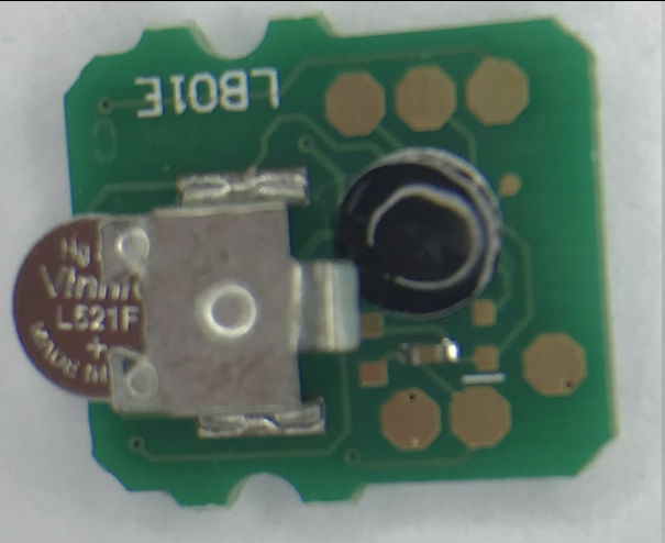

SeNNinhA Δημοσ. 6 Φεβρουαρίου Δημοσ. 6 Φεβρουαρίου (επεξεργασμένο) 9 ώρες πριν, smpt είπε αν το τονερ του συγκεκριμένου εκτυπωτή δεν έχουν τσιπάκι, τότε πως φταίει το firmware? Κι ομως εχουν οπως εχει η πλειονοτητα των toners Toner Cartridges for Brother MFC-L3770CDW Printer (123ink.ca) Και οχι μονο αυτο αλλα εχει και μπαταρια....!!!! Ελεος Just thought I'd share this. I have a L3770CDW that suddenly woke up and said the Magenta is no good anymore. Can't detect cartridge. TN227 and TN223s. After some investigation, it turns out the just the chip went bad, or so I thought. I decided to take some time and really examine this chip that came with it. Turns out that the chip is powered by a battery, which is in itself stupid, it should draw power from the printer. SIMPLE SOLUTION: Remove the chip on the toner (some chips slide out and others pry off.) On the underside of the chip is a small battery size 379 (old model # is sr521sw.) Replace the tiny battery and reinstall the chip. It is quite easy and the battery is a watch battery and very cheap (20 batteries for $5 on Amazon.) 3 of my 4 printer toners had a red "X" through them in the printer display and once I replaced the batteries the toners printed https://www.tonerstop.com.au/black-compatible-toner-reset-chip Μαρτυρια τεχνικου I had a customer recently bring in a Brother MFC-L3770CDW, stating that the generic (Non-OEM) TN227 (black) toner we supplied him did not work in his machine. After messing around with it for a bit, I updated the firmware thinking that the firmware version on the machine might be in conflict with the chip on the toner. The firmware was on version 1.56, so I updated it to 1.59. After updating, it went from saying "Replace Toner" to "No Toner". I went in to maintenance mode, and it gave a 2500 error (cannot communicate with black cartridge chip). I reset the black toner, swapped out the cartridge, and restarted the machine but that did not work. I unfortunately do not have an OEM toner at this time, so I was not able to test if switching to an OEM would fix it. Has anyone else dealt with an issue like this before? Any advice is appreciated. By the way: How to reset the toner Bottom line: Εαν δεν ειναι η μπαταρια και δεν θελεις ή δεν μπορεις να πας σε προηγουμενο firmware πρεπει να βρεις προμηθευτη συμβατων toners που να μπορει να σου φερει toners με τα νεα τσιπακια συμβατα με το τελευταιο firmware. Οπως ειπα οταν συνεβη σε εμενα απλα μου αλλαξαν το toner με νεας παραλαβης κομματι και επαιξε αμεσως. Επεξ/σία 6 Φεβρουαρίου από SeNNinhA 1 1
NiKoSmile Δημοσ. 1 Μαρτίου Δημοσ. 1 Μαρτίου Κράτησα ένα "μη" αναγνωρίσιμο chip (μετά από διακοπή ρεύματος) με μπαταρία από συμβατό ΤΝ-2420 (Brother DCP-L2530DW). Απ ότι βλέπω έχει μπαταρία L521F (1€ οι 10). Αξίζει από περιέργεια να δοκιμάσω να την αλλάξω...
SeNNinhA Δημοσ. 1 Μαρτίου Δημοσ. 1 Μαρτίου 46 λεπτά πριν, NiKoSmile είπε Κράτησα ένα "μη" αναγνωρίσιμο chip (μετά από διακοπή ρεύματος) με μπαταρία από συμβατό ΤΝ-2420 (Brother DCP-L2530DW). Απ ότι βλέπω έχει μπαταρία L521F (1€ οι 10). Αξίζει από περιέργεια να δοκιμάσω να την αλλάξω... Γιατί όχι?
