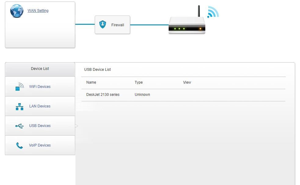

pstcho Δημοσ. 25 Ιανουαρίου 2023 Δημοσ. 25 Ιανουαρίου 2023 Hello there, sorry for my english but i dont speak greek well i changed rescently from vodafone to cosmote and since i got this new router, i cant setup my printer through the router the printer works fine in USB on the computer, cables are good, power supply also, i just cant get it recognized on the router or the computer ( windows 10 ) if you hadany tip, i would appreciate thank you
