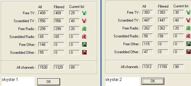

FELIX Δημοσ. 3 Μαρτίου 2005 Δημοσ. 3 Μαρτίου 2005 1)to tuner.sthn skystar 1 einai philips kai poly eyais8hto.klaseis anwtero apo ayto ths ss2 .sthn eikona fenete to apotelesma meta apo scan me tis 2 kartes sto idio piato-lnb(120-0,5db) thn idia wra ths hmeras ston hotbird. 2)h xrhsh cpu.h ss1 me enswmatwmeno (hardware ) mpeg2 decoder xrhsimopoiei elaxisto ews ka8olou cpu,ara einai kalyterh gia adynata systhmata. 3)to zaping.sthn ss1 einai poly grhgoro sxedon antistoixo enos kanonikou digital reciver,se anti8esh me to argo zap ths ss2 4)parexei exodous gia aristh poiothta av se tv se anti8esh me thn ss2 pou apaitei karta grfikwn me tv out gia na ginei ayto.epishs parexei taytoxronh 8eash sto pc kai sthn tv. 5)h timh.h ss1 einai 2+ fores pio akribh to mono arnhtiko stoixeio ths.kata ta alla mporei na kanei oti kai h ss2 kai yposthrizete apo olla ta gnwsta dvb software. 6)se programmata opws to prog dvb me xrhsh ss1 yparxoun arketa extra menu kai ry8miseis pou den yparxoun me xrhsh ths ss2. 7)elafra kalyterh poiothta sthn eikona xwris ta mikra kena-pagwmatakia pou kanei h ss2 merikes fores se eikona kai hxo.arnhtiko edw oti den ta paei kala me ati gpu.apodidei poly kalytera me nvidia. to 8ema yper8ermanshs ths ss1 den nomizw na isxyei pia,den eida kapoia diafora sth 8ermokrasia kai h ss2 ti idio zestenete,opws alwste kai o ka8e dvb reciver.an to case exei kalh roh aera den exei pote problhma. fysika kai den prwteinw thn agora ths ss1 afou me ligotero apo ta misa xrhmata mporoume na agorasoume mia ss2 kai na kanoume thn idia douleia,xwris shmantikes apwleies se kanena tomea,ektos thn pio adynaths lypshs,pou omws den apasxolei kai polous.

FELIX Δημοσ. 4 Μαρτίου 2005 Δημοσ. 4 Μαρτίου 2005 o humax exei apo ta poly kala tuners kai sigoura 8a sou katebazei poly perisotera apo thn ss2.twra oso exei na kanei me to hdtv h skystar 1 gia na to deixei prepei apo to menu tou prog dvb na thn oriseis san software mode aliws den to deixnei,me ton onboard mpe2 decoder ths den ginete ayto.mono hxo akous.h ss2 outws h alws den exei hardware decoder kai einai se soft mode.apo poiothta kai eikona se soft mode einai to idio kai oi 2 aytes kartes.kai ena tip gia na pezei apsoga to hdtv.apo to menou tu progdvb>audio and video options>timeshift buffer ta 10 mb pou einai ex arxhs einai liga.an to systhma sou exei polh ram orise megalytero buffer.egw me 1024 ram tou exw orisei 128 mb.an den exeis arketh ram alazeis thn epilogh in file kai xrhsimopoiei buffer apo ton disko sou.mporeis na dwseis osa mb 8eleis.to led tou diskou omws 8a anabosbhnei synexeia etsi(xrhsimopoiei ton disko)me ayto ton tropo to hdtv pezei apsoga me omalh kinhsh kai teleia eikona. oso gia th lypsh ths ss1 sou dinw edw:http://briefcase.pathfinder.gr/download/felixfelix/15945/393109/0/italia.JPG ena paradeigma me to sky italia pou einai dyskolo paketo.den exoun omws olla ta kanalia poly shma alla akoma kai me 2-3% pezoun kala xwris pixelation.to brady omws pou peftei to shma h lypsh einai xeiroterh. epishs sthn perioxh pou eimai(notia) exw 8ewrhtika kalyterh lypsh apo esena sto paketo ayto.afou exeis hdh dvb karta den nomizw oti axizei na thn alaxeis gia na pareis ss1.

FELIX Δημοσ. 4 Μαρτίου 2005 Δημοσ. 4 Μαρτίου 2005 nai gia ton zois gr elega.xania me hrakleio exoume sigoura diafores sthn lhpsh tou sygkekrimenou paketou.twra pou les gia to 28% stis endeixeis ths ss2 exeis dikio.thn exw ligotero apo ebdomada kai den to eixa dei.ontws parakatw apo 28% den deixnei.sthn ss1 oi dyo mpares signal kai quality deixnoun diforetikes endeixeis kai oxi to idio kai oi dyo.px signal 8% kai quality 40% sth ss2 panta to idio kai oi 2 mpares...malon 8ema driver einai.den exw dokimasei alon driver mono ayto pou eixe sto cd.h karta einai version 2,6d.sthn ss1 3 xronia twra xekinhsa me driver 2.10 kai exei paei 2.18 twra.me ena kalytero lnb sigoura 8a deis diafora.oute egw den exw kanena kalo lnb omws ena humax 0,5db exw twra kai 2 xronia to krataw omws giati ta paei kala me ton dreambox enw ena 0,3 pu dokimasa(no name) htan xeirotero.
zois_gr Δημοσ. 4 Μαρτίου 2005 Δημοσ. 4 Μαρτίου 2005 felix- tzinos sigoura xania me iraklio exi poli diafora se thema simatos kai mou kani endiposi pos den pianete olo to paketo sky italia i tps ara malon kati prepi na kanis se thema lnb felix ego exo invacom 0.3 tzinos apkliete gia liges leptomeries na alakso apo ss2 se ss1 kseris ine kai i diafora xrimaton. aplos tha kano afto pou mou ipes me to buffer bas kai petixo to hd sto prog dvb i mnimi pou exo ine 512 . enas filos o dwerves mou ipe oti i ikona sto prog dvb me to alt dvb ine klasis kaliteri giafto prospatho na petixo hd sto prog dvb .
