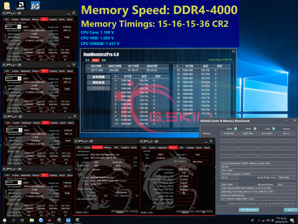

Reaper Lords Δημοσ. 21 Οκτωβρίου 2019 Δημοσ. 21 Οκτωβρίου 2019 (επεξεργασμένο) G.SKILL Announces Extreme Low Latency DDR4-4000 CL15 32GB (8GBx4) Memory Kits Exceptional Bandwidth Performance on AMD X570 A lower CAS latency typically means a bump in bandwidth performance, and this is no different on the latest AMD Ryzen platform. Normally, AMD Ryzen 9 3900X processor bandwidth with popular DDR4-3200 CL14 kit would fall around 50GB/s for memory read bandwidth in AIDA64. With the new ultra-efficient DDR4-4000 CL15 memory kit, the memory read bandwidth breaks 61GB/s in AIDA64 with a few additional tweaks, along with over 58GB/s in memory write and 65GB/s in memory copy bandwidth speed, as demonstrated in the following screenshot with the MSI X570 Unify motherboard and the AMD Ryzen 9 3900X processor. https://www.gskill.com/community/1502239313/1571638896/G.SKILL-Announces-Extreme-Low-Latency-DDR4-4000-CL15-32GB-(8GBx4)-Memory-Kits AMD Ryzen Threadripper 3990X is confirmed https://videocardz.com/82293/exclusive-amd-ryzen-threadripper-3960x-3970x-and-3990x-launch-dates-leaked Επεξ/σία 21 Οκτωβρίου 2019 από Reaper Lords

akoinonitos Δημοσ. 21 Οκτωβρίου 2019 Μέλος Δημοσ. 21 Οκτωβρίου 2019 18 λεπτά πριν, Reaper Lords είπε G.SKILL Announces Extreme Low Latency DDR4-4000 CL15 32GB (8GBx4) Memory Kits Exceptional Bandwidth Performance on AMD X570 A lower CAS latency typically means a bump in bandwidth performance, and this is no different on the latest AMD Ryzen platform. Normally, AMD Ryzen 9 3900X processor bandwidth with popular DDR4-3200 CL14 kit would fall around 50GB/s for memory read bandwidth in AIDA64. With the new ultra-efficient DDR4-4000 CL15 memory kit, the memory read bandwidth breaks 61GB/s in AIDA64 with a few additional tweaks, along with over 58GB/s in memory write and 65GB/s in memory copy bandwidth speed, as demonstrated in the following screenshot with the MSI X570 Unify motherboard and the AMD Ryzen 9 3900X processor. https://www.gskill.com/community/1502239313/1571638896/G.SKILL-Announces-Extreme-Low-Latency-DDR4-4000-CL15-32GB-(8GBx4)-Memory-Kits AMD Ryzen Threadripper 3990X is confirmed https://videocardz.com/82293/exclusive-amd-ryzen-threadripper-3960x-3970x-and-3990x-launch-dates-leaked Τι να τις κανεις αυτες τις μνημες οταν εχει χειροτερα νουμερα απο 3600Mhz .... Xεσε μας ρε gskill 2
