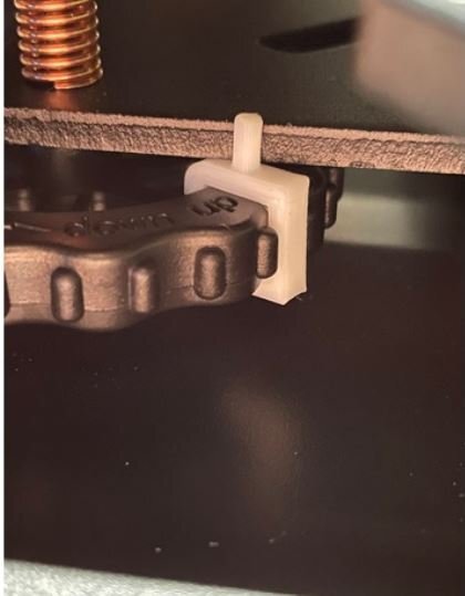

χαχαχα...μόλις βρήκα και lock για το bed του ender 3 s1 pro που ξεβίδωνε κατά την εκτύπωση και δεν με πιστεύατε!Εξυπνο!
Και ο τύπος λέει
"How did I end up making my own bed level locks? Well, after spending quite some time leveling, especially the fine tuning after ABL (E3S1Pro users probabely know, that ABL isn't perfect and needs subsequent adjustments on the fly)"
https://www.thingiverse.com/thing:5858852
