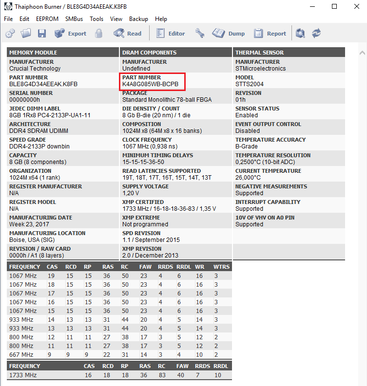

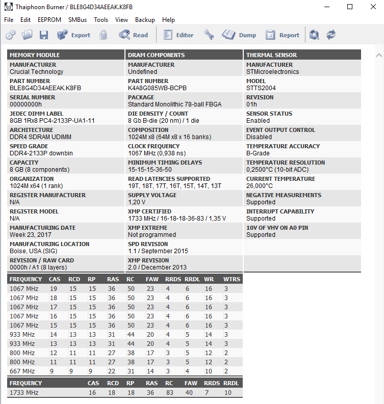

tanasen01 Δημοσ. 13 Νοεμβρίου 2017 Δημοσ. 13 Νοεμβρίου 2017 Uhm, καταρχάς γιατί είναι τόσο φθηνή αυτή? Επίσης είναι b-die όλα μοντέλα αυτής της σειράς? Δλδ και η 3000 έκδοση? Και από που ξέρεις ότι είναι b-die? Όχι, μιλάμε μόνο για το μοντέλο BLE4K8G4D34AEEAK http://www.relaxedtech.com/reviews/ballistix/elite-3466mhz-32gb-memory-kit/1 "Above is a screenshot from Thaiphoon Burner showing more details and as you can see, the memory IC used here is based on the Samsung B-die. Samsung B-die's are known for high overclocking and normally respond better when you increase the voltage and can also tolerate much tighter timings and higher temperatures. The B-die has a superior lithography compared to the competition which explains why it's in high demand from enthusiasts."
IoaZ Δημοσ. 13 Νοεμβρίου 2017 Δημοσ. 13 Νοεμβρίου 2017 Όχι, μιλάμε μόνο για το μοντέλο BLE4K8G4D34AEEAK http://www.relaxedtech.com/reviews/ballistix/elite-3466mhz-32gb-memory-kit/1 "Above is a screenshot from Thaiphoon Burner showing more details and as you can see, the memory IC used here is based on the Samsung B-die. Samsung B-die's are known for high overclocking and normally respond better when you increase the voltage and can also tolerate much tighter timings and higher temperatures. The B-die has a superior lithography compared to the competition which explains why it's in high demand from enthusiasts." Δεν βλέπω να γράφει samsung στο screenshot Thaiphoon Burner . Το μόνο που βλέπω είναι ότι γράφει b-die και όχι samsung . B-die έχουν και η micron . Όχι, μιλάμε μόνο για το μοντέλο BLE4K8G4D34AEEAK http://www.relaxedtech.com/reviews/ballistix/elite-3466mhz-32gb-memory-kit/1 "Above is a screenshot from Thaiphoon Burner showing more details and as you can see, the memory IC used here is based on the Samsung B-die. Samsung B-die's are known for high overclocking and normally respond better when you increase the voltage and can also tolerate much tighter timings and higher temperatures. The B-die has a superior lithography compared to the competition which explains why it's in high demand from enthusiasts."

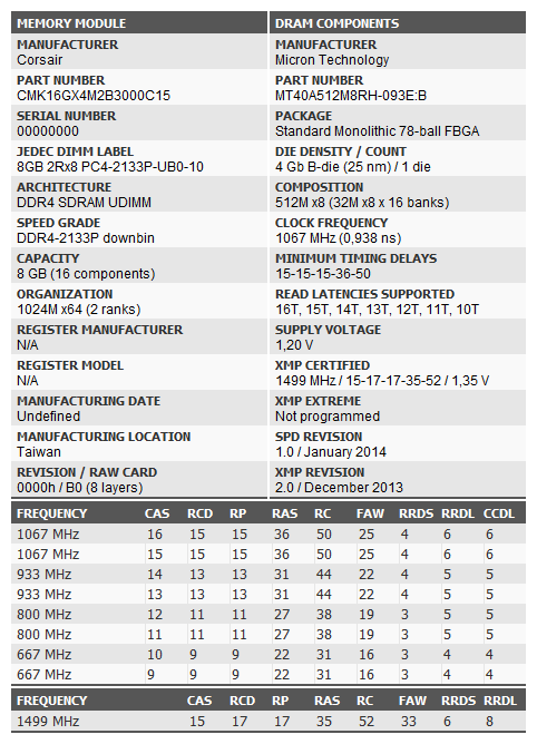

akoinonitos Δημοσ. 13 Νοεμβρίου 2017 Δημοσ. 13 Νοεμβρίου 2017 επισης γραφει B-die 25nm οχι b-die 20nm που ειναι της samsung και ο κωδικος της δεν ταιριαζει με των samsung Οι δικες μου για παραδειγμα δεν γραφουν manufacturer αλλα εχουν τα υπολοιπα 1

Heybro Δημοσ. 13 Νοεμβρίου 2017 Δημοσ. 13 Νοεμβρίου 2017 16 18 18 36 timings που βλέπω στην εικόνα πάντως είναι σίγουρα hynix εκτός και αν τα άλλαξες εσύ.
IoaZ Δημοσ. 13 Νοεμβρίου 2017 Δημοσ. 13 Νοεμβρίου 2017 Πάντως άμα βρίσκαμε φωτογραφία στο internet από τις Crucial Ballistix Elite 16GB Kit (2 x 8GB) DDR4-3466 CL16 χωρίς ψήκτρα θα βλέπαμε τη είναι . ( Δεν υποστηρίζω ότι δεν είναι samsung απλά δεν με πείθει το screenshot Thaiphoon Burner από http://www.relaxedtech.com/reviews/ballistix/elite-3466mhz-32gb-memory-kit/1 )

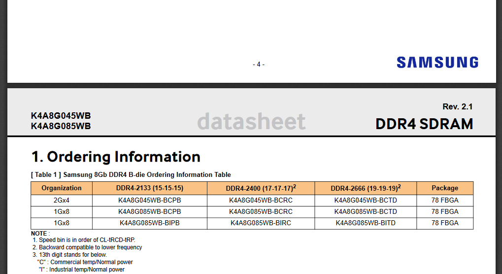

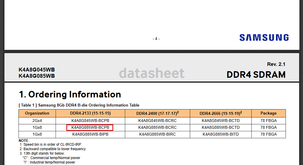

akoinonitos Δημοσ. 13 Νοεμβρίου 2017 Δημοσ. 13 Νοεμβρίου 2017 Δεν βλέπω να γράφει samsung στο screenshot Thaiphoon Burner . Το μόνο που βλέπω είναι ότι γράφει b-die και όχι samsung . B-die έχουν και η micron . 952616d1494449466-16-gb-dual-rank-corsair-snap10052017224603 (1).png Απο που ειναι αυτο το thaiphoon ρε συ με μπερδεψες Δες το δικο μου που ανεβασα πιο πανω ,εσυ εβαλες ενα απο corsair Δες τον κωδικο για τα d ram components ειναι αυτο απο το data της samsung

IoaZ Δημοσ. 13 Νοεμβρίου 2017 Δημοσ. 13 Νοεμβρίου 2017 Το thaiphoon είναι από εδώ https://www.hardwareluxx.de/community/f13/hardwareluxx-spd-datenbank-ddr4-ic-liste-last-update-10-11-17-a-1073628.html Απλά το ανέφερα για να αποδείξω ότι υπάρχουν b-die micron . 1
akoinonitos Δημοσ. 13 Νοεμβρίου 2017 Δημοσ. 13 Νοεμβρίου 2017 Το thaiphoon είναι από εδώ https://www.hardwareluxx.de/community/f13/hardwareluxx-spd-datenbank-ddr4-ic-liste-last-update-10-11-17-a-1073628.html Απλά το ανέφερα για να αποδείξω ότι υπάρχουν b-die micron . A τωρα το εκανες λιανο ,δες απο πανω που ανεβασα για τι ballistix elite 1201 bios για την Asus X370 Pro Δοκιμασε κανεις; Δως μου λιγο χρονο 1
