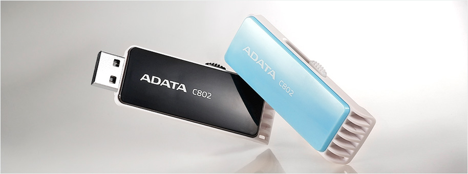

AccountSaver Δημοσ. 9 Φεβρουαρίου 2014 Μέλος Δημοσ. 9 Φεβρουαρίου 2014 Adata 1100 4 GB έτσι γράφει στο "ιδιότητες"... αυτό σε μαύρο ... http://www.techbuy.com.au/images/extra/16/5/e2011030754145.jpg
Captain Nemo Δημοσ. 9 Φεβρουαρίου 2014 Δημοσ. 9 Φεβρουαρίου 2014 Adata 802 4gb Start by searching for the USB Controller Vendor and Product ID. This can be done by simply opening the USB flash drive, and you find it written on the controller or by using a utility, such as usbview ,a free usb device viewer that lists all usb devices connected to the computer, or CheckUDisk – USB Flashdrive Information Tool and ChipGinus. If the utility finds the USB drive, this mean that you have a chance to repair it.Now the question what to do with this ID? First we check http://www.flashboot.ru/iflash.html to have the details about how to fix the controller, for each manufacture there you find its own utility to fix controller. So you need to follow the indicated instructions (downloading the utility and follow required actions to get it back working.That’s it wish you a good chance in recovering and repairing your USB devices!http://www.ftdichip.com/Support/Utilities/usbview.ziphttp://www.pendriveapps.com/goto/HERE/458/1http://flashboot.ru/iflash/ Εδώ έχει κάποιο εργαλείο http://www.flashdrive-repair.com/2013/04/a-data-usb-flash-disk-format-tool-and.html http://www.mediafire.com/download/19e15bso0yd6moo/A-DATA-1166682519_USB_Flash_Disk_Utility_USBest.rar και εδώ κάποιο άλλο http://flashboot.ru/files/file/315/ http://flashboot.ru/forum/index.php?topic=13924.0 και εδώ κάτι http://usb-fix.blogspot.gr/p/usbest_03.html και εδώ κάποιες αναφορές http://flashboot.ru/files/file/304/ και εδώ κάποιο άλλο http://www.myusbtools.com/2013/08/adata-usb-utility-richip-f203.html γενικά θέλει ψάξιμο http://dl.mydigit.net/special/up/ite.html
