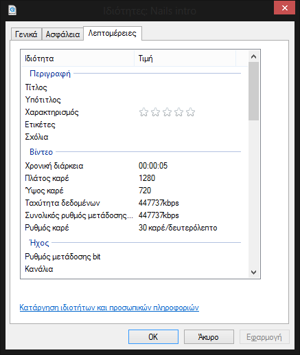

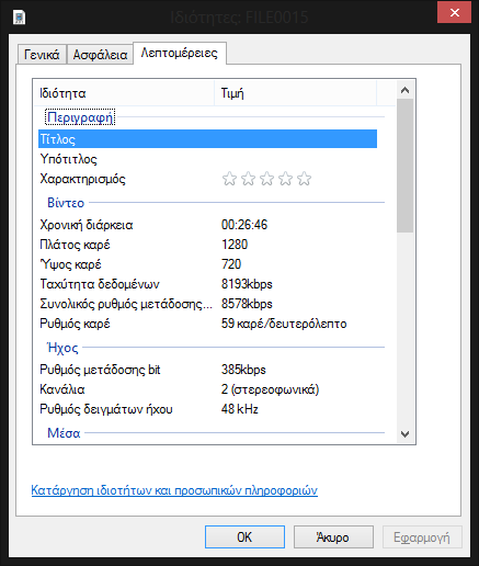

Αυτό είναι του βίντεο:
και αυτό το intro από το c4d

αρχικό
General
Complete name                            : C:\Users\Evoracing\Desktop\FILE0015.AVI
Format                                   : AVI
Format/Info                              : Audio Video Interleave
File size                                : 1.60 GiB
Duration                                 : 26mn 46s
Overall bit rate mode                    : Constant
Overall bit rate                         : 8 579 Kbps
Recorded date                            : 2007-11-28
Writing library                          : AMBA
ICRT                                     : 02:42:50
Video
Format                                   : AVC
Format/Info                              : Advanced Video Codec
Format profile                           : [email protected]
Format settings, CABAC                   : Yes
Format settings, ReFrames                : 4 frames
Format settings, GOP                     : M=3, N=15
Codec ID                                 : H264
Duration                                 : 26mn 46s
Bit rate mode                            : Constant
Bit rate                                 : 8 181 Kbps
Nominal bit rate                         : 4 001 Kbps
Width                                    : 1 280 pixels
Height                                   : 720 pixels
Display aspect ratio                     : 16:9
Frame rate                               : 59.940 fps
Color space                              : YUV
Chroma subsampling                       : 4:2:0
Bit depth                                : 8 bits
Scan type                                : Progressive
Bits/(Pixel*Frame)                       : 0.148
Stream size                              : 1.53 GiB (95%)
Audio
Format                                   : ADPCM
Codec ID                                 : 11
Codec ID/Hint                            : Intel
Duration                                 : 26mn 46s
Bit rate                                 : 384 Kbps
Channel(s)                               : 2 channels
Sampling rate                            : 48.0 KHz
Bit depth                                : 4 bits
Stream size                              : 73.8 MiB (4%)
Interleave, duration                     : 43 ms (2.55 video frames)
intro
General
Complete name                            : C:\Users\Evoracing\Desktop\Nails intro.mov
Format                                   : MPEG-4
Format profile                           : QuickTime
Codec ID                                 : qt
File size                                : 320 MiB
Duration                                 : 5s 700ms
Overall bit rate mode                    : Variable
Overall bit rate                         : 471 Mbps
Encoded date                             : UTC 2013-06-01 22:33:10
Tagged date                              : UTC 2013-06-01 23:49:51
Writing library                          : Apple QuickTime
Video
Format                                   : RLE
Format/Info                              : Run-length encoding
Codec ID                                 : rle
Duration                                 : 5s 700ms
Bit rate mode                            : Variable
Bit rate                                 : 471 Mbps
Height                                   : 720 pixels
Frame rate mode                          : Constant
Frame rate                               : 30.000 fps
Bits/(Pixel*Frame)                       : 17.047
Stream size                              : 320 MiB (100%)
Language                                 : English
