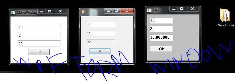

Εαν σε εμπνεει κατι απο τα παρακατω :P.
c# wpf
code part 1 (C#)
>using System;
using System.Windows;
namespace wpf_test
   /// <summary>
   /// Interaction logic for MainWindow.xaml
   /// </summary>
   public partial class MainWindow : Window
       public MainWindow()
           InitializeComponent();
       private void btnOk_Click(object sender, RoutedEventArgs e)
           try
               tbout.Text = (double.Parse(tbin1.Text) + double.Parse(tbin2.Text)).ToString();
           catch (Exception)
code part 2 (xml)
><Window x:Class="wpf_test.MainWindow"
       xmlns="http://schemas.microsoft.com/winfx/2006/xaml/presentation"
       xmlns:x="http://schemas.microsoft.com/winfx/2006/xaml"
       Title="MainWindow" Height="200" Width="211">
   <Grid>
       <TextBox  HorizontalAlignment="Center" Margin="0,24,0,0" Name="tbin1" VerticalAlignment="Top" Width="150" />
       <TextBox  HorizontalAlignment="Center" Margin="0,53,0,0" Name="tbin2" VerticalAlignment="Top" Width="150" />
       <TextBox  HorizontalAlignment="Center" Margin="0,82,0,0" Name="tbout" VerticalAlignment="Top" Width="150" />
       <Button Content="Ok" Height="23" HorizontalAlignment="Center" Margin="0,111,0,0" Name="btnOk" VerticalAlignment="Top" Width="75" Click="btnOk_Click" />
   </Grid>
</Window>
c# win gdi
>using System.Collections.Generic;
using System.Linq;
using System.Windows.Forms;
using System.Drawing;
namespace wfa_test
   static class Program
       /// <summary>
       /// The main entry point for the application.
       /// </summary>
       [sTAThread]
       static void Main()
           Application.EnableVisualStyles();
           Application.SetCompatibleTextRenderingDefault(false);
           Application.Run(new Form1());
   public class Form1 : Form
       private TextBox tbin1;
       private TextBox tbin2;
       private TextBox tbout;
       private Button btnOk;
       public Form1()
           tbin1 = new TextBox { Location = new Point { X = 20, Y = 20 } };
           tbin2 = new TextBox { Location = new Point { X = 20, Y = 50 } };
           tbout = new TextBox { Location = new Point { X = 20, Y = 80 }, ReadOnly = true };
           btnOk = new Button { Location = new Point { X = 30, Y = 110 }, Text = "Ok" };
           this.Height = this.Width = 200;
           btnOk.Click += (sender,e) =>
               try
               catch (Exception)
           this.Controls.AddRange(new Control[] { tbin1, tbin2, tbout, btnOk });
native gdi (c/c++) :mrgreen:

>βαρετο
Διαλεγεις και περνεις. Υπαρχουν πολλα gdi apis, αυτα ειναι μονο για windows.
output
BTW: Ξερει κανεις να μου πει πως βαζουμε τα default style στο native api των windows; Δε γινετε να φτιαχνω ενα κουμπι και αυτο να ειναι σαν αυτα των win98
Για τον φίλο που ρώτησε το αρχικό ερώτημα: υπάρχουν πολλές λύσεις. Η δική μου "συμβουλή" είναι να διαλέξεις μία και να ξεκινήσεις! Τρώγοντας έρχεται η όρεξη! ;)

output
[ATTACH]32818[/ATTACH]
