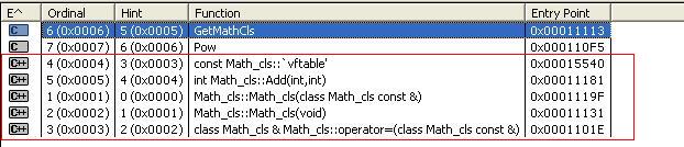

Evgenios1 Δημοσ. 20 Οκτωβρίου 2009 Μέλος Δημοσ. 20 Οκτωβρίου 2009 Απο αρκετο ψαξιμο και πειραματισμο, καταλαβα οτι η LoadLibrary etc.. ειναι για c functions/variables .Αν θελω να κανω export μια class, πως θα κανω? Μεχρι τωρα εχω κανει το εξης. >[color="#008000"][i]// capp.cpp : Defines the entry point for the console application.[/i][/color] [color="#008000"][i]//[/i][/color] [color="#0000ff"]#include[/color] [color="#a31515"]"stdafx.h"[/color] [color="#0000ff"]#pragma[/color] comment(lib,[color="#a31515"]"E:\\mathdll.lib"[/color]) [color="#0000ff"]#define[/color] DLLPATH L[color="#a31515"]"E:\\mathdll.dll"[/color] [color="#0000ff"][b]class[/b][/color] __declspec(dllimport) Math { [color="#0000ff"][b]public[/b][/color]: [color="#8000ff"]int[/color] Add([color="#8000ff"]int[/color] a,[color="#8000ff"]int[/color] ; }; [color="#0000ff"][b]typedef[/b][/color] [color="#8000ff"]int[/color] (__cdecl *Pow)([color="#8000ff"]int[/color],[color="#8000ff"]int[/color]); [color="#0000ff"][b]typedef[/b][/color] HINSTANCE (__cdecl *GetMathCls)([color="#0000ff"][b]void[/b][/color]); [color="#8000ff"]int[/color] WaitForExit(HINSTANCE lib); [color="#8000ff"]int[/color] _tmain([color="#8000ff"]int[/color] argc, _TCHAR* argv[]) { HINSTANCE hLib = LoadLibrary(DLLPATH); [color="#0000ff"][b]if[/b][/color](hLib==NULL) { printf([color="#a31515"]"apotyxia fortoshs %lstoy dll\n"[/color]); [color="#0000ff"][b]return[/b][/color] WaitForExit(NULL); } Pow pPow = (Pow)GetProcAddress(hLib,[color="#a31515"]"Pow"[/color]); [color="#0000ff"][b]if[/b][/color](pPow == NULL) { printf([color="#a31515"]"apotyxia fortoshs ths synarthshs\n"[/color]); [color="#0000ff"][b]return[/b][/color] WaitForExit(hLib); } printf([color="#a31515"]"h Pow fortose:2^4=%d\n"[/color],pPow([color="#ff8000"]2[/color],[color="#ff8000"]4[/color])); [color="#0000ff"][b]void[/b][/color] *pMath = ([color="#0000ff"][b]void[/b][/color]*) [color="#0000ff"][b]new[/b][/color] [color="#8000ff"]char[/color][[color="#0000ff"][b]sizeof[/b][/color](Math)]; GetMathCls getMath = (GetMathCls)GetProcAddress(hLib,[color="#a31515"]"GetMathCls"[/color]); HINSTANCE hMathCls = getMath(); [color="#0000ff"][b]if[/b][/color](hMathCls==NULL) { printf([color="#a31515"]"den einai dynath h fortosh ths Math_Cls"[/color]); WaitForExit(hLib); } memcpy(pMath,hMathCls,[color="#0000ff"][b]sizeof[/b][/color](Math)); Math *newMath = (Math*)pMath; [color="#008000"][i]//printf("4+4=%d\n",newMath->Add(4,4));[/i][/color] [color="#0000ff"][b]delete[/b][/color][] pMath; [color="#0000ff"][b]return[/b][/color] WaitForExit(hLib); } [color="#8000ff"]int[/color] WaitForExit(HINSTANCE lib) { FreeLibrary(lib); getchar(); [color="#0000ff"][b]return[/b][/color] [color="#ff8000"]0[/color]; } Η γκρινια του compiler ειναι για αυτο εδω το κομματι >printf("4+4=%d\n",[color="Red"]newMath->Add(4,4)[/color]); μου λεει οτι δε βρισκει τα symbols ... Εγω του λεω οτι ειναι εδω >#pragma comment(lib,"E:\\mathdll.lib") αλλα αυτος επιμενει οτι δε τα βρισκει.... το api ειναι αυτο. >[color="#0000ff"]#pragma[/color] once [color="#0000ff"]#ifdef[/color] MATH_EXPORT [color="#0000ff"]#define[/color] MATH_API __declspec(dllexport) [color="#0000ff"]#else[/color] [color="#0000ff"]#define[/color] MATH_API __declspec(dllimport) [color="#0000ff"]#endif[/color] [color="#0000ff"][b]class[/b][/color] MATH_API Math_cls { [color="#0000ff"][b]public[/b][/color]: [color="#8000ff"]int[/color] Add([color="#8000ff"]int[/color] a,[color="#8000ff"]int[/color] ; }; [color="#0000ff"][b]extern[/b][/color] [color="#a31515"]"C"[/color] MATH_API [color="#8000ff"]int[/color] Pow([color="#8000ff"]int[/color] base,[color="#8000ff"]int[/color] exp); [color="#0000ff"][b]extern[/b][/color] [color="#a31515"]"C"[/color] MATH_API HINSTANCE GetMathCls([color="#0000ff"][b]void[/b][/color]);
bxenos Δημοσ. 20 Οκτωβρίου 2009 Δημοσ. 20 Οκτωβρίου 2009 κλικ....... Δες το κομμάτι με τα interfaces/abstruct classes. Θα χρησιμοποιήσεις το naming convertion που έχει χρησιμοποιηθεί στο dll φυσικά απο τον compiler
Evgenios1 Δημοσ. 20 Οκτωβρίου 2009 Μέλος Δημοσ. 20 Οκτωβρίου 2009 Αυτο ηταν? ενα virtual ? thx τωρα ειναι μια χαρα! >// capp.cpp : Defines the entry point for the console application. // #include "stdafx.h" #pragma comment(lib,"E:\\mathdll.lib") #define DLLPATH L"E:\\mathdll.dll" class __declspec(dllimport) Math { public: virtual int Add(int a,int =0; }; typedef int (__cdecl *Pow)(int,int); typedef Math* (__cdecl *GetMathCls)(void); int WaitForExit(HINSTANCE lib); int _tmain(int argc, _TCHAR* argv[]) { HINSTANCE hLib = LoadLibrary(DLLPATH); if(hLib==NULL) { printf("apotyxia fortoshs %lstoy dll\n"); return WaitForExit(NULL); } Pow pPow = (Pow)GetProcAddress(hLib,"Pow"); if(pPow == NULL) { printf("apotyxia fortoshs ths synarthshs\n"); return WaitForExit(hLib); } printf("h Pow fortose:2^4=%d\n",pPow(2,4)); GetMathCls getMath = (GetMathCls)GetProcAddress(hLib,"GetMathCls"); Math *pMath = getMath(); if(pMath==NULL) { printf("den einai dynath h fortosh ths Math_Cls"); WaitForExit(hLib); } printf("4+4=%d\n",pMath->Add(4,4)); delete[] pMath; return WaitForExit(hLib); } int WaitForExit(HINSTANCE lib) { FreeLibrary(lib); getchar(); return 0; }

Evgenios1 Δημοσ. 21 Οκτωβρίου 2009 Μέλος Δημοσ. 21 Οκτωβρίου 2009 κλικ....... Δες το κομμάτι με τα interfaces/abstruct classes. Θα χρησιμοποιήσεις το naming convertion που έχει χρησιμοποιηθεί στο dll φυσικά απο τον compiler Διαβασα ολο το αρθρο και τωρα καταλαβα αυτη τη προταση σου... Δηλαδη ελεος, τι παλουκι ειναι αυτο!! Δηλαδη απο αυτο το dll μπορεις να χρησιμοποιησεις μονο το Pow και GetMathCls? Ενω για τα αλλα πρεπει να εχεις τον ιδιο compiler που εχω και εγω? Δηλαδη το DirectX SDK πχ ειναι μονο για ms vc++ ?
bxenos Δημοσ. 21 Οκτωβρίου 2009 Δημοσ. 21 Οκτωβρίου 2009 Διαβασα ολο το αρθρο και τωρα καταλαβα αυτη τη προταση σου... Δηλαδη ελεος, τι παλουκι ειναι αυτο!! ... Αν έχεις άλλο compiler ίσως είναι μπέρδεμα. Λέω ισως γιατί τα ονόματα είναι αρκετά τυποποιημένα εδω και αρκετό καιρό (ευτυχώς) και δεν πρέπει να διαφέρουν απο compiler και compiler. Τα ονόματα των συναρτησεων στη C++ όπως τα φτιάχνει o compiler έχουν μέσα τους και το class που ανήκουν, τον τύπο (virtual,...) και τις παραμέτρους της συνάρτησης γι'αυτο υπήρχε το μπέρδεμα με το να τις βρείς/καλέσεις. Όταν αρχικά σχεδίασαν τα DLL είχαν σκεφτεί μόνο τα extern "C" σαν entry points. Μετά προσαρμόστηκε η C++ πάνω τους.
