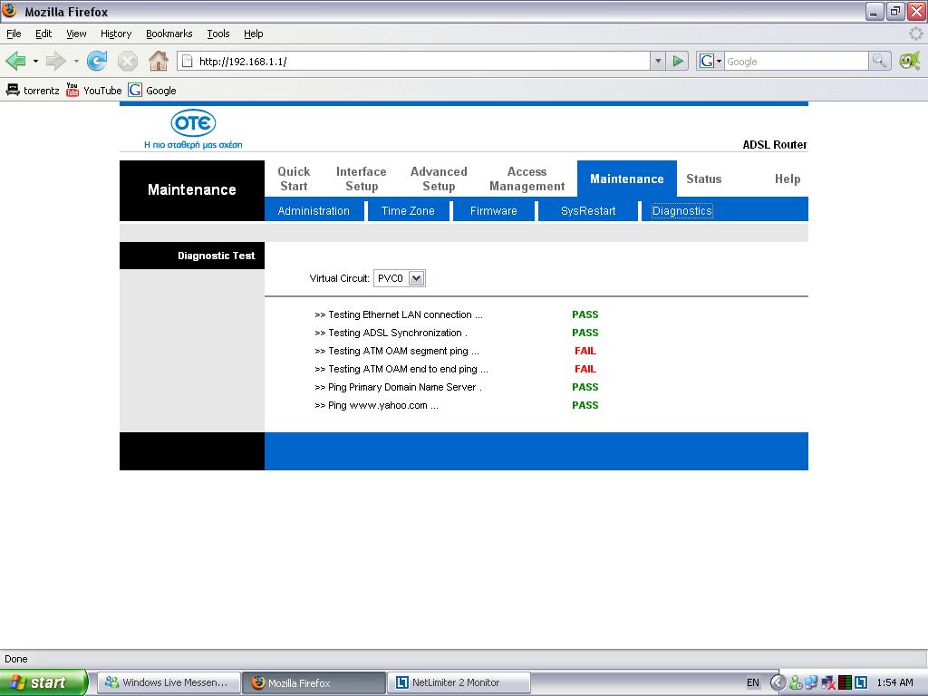

RoflCrit Δημοσ. 24 Νοεμβρίου 2007 Δημοσ. 24 Νοεμβρίου 2007 Τι είναι τα testing ATM OMA segment ping kai testing ATM OMA end to end ping και τι παιζει με το FAIL pou exei bgalei??? parakalo e3igiste mou ty
poulinos Δημοσ. 24 Νοεμβρίου 2007 Δημοσ. 24 Νοεμβρίου 2007 The ATM OAM Ping feature sends an ATM Operation, Administration, and Maintenance (OAM) packet to confirm the connectivity of a specific permanent virtual circuit (PVC). The status of the PVC is displayed when a response to the OAM packet is received. The ATM OAM Ping feature allows the network administrator to verify PVC integrity and facilitates ATM network troubleshooting me apla logia einai kapoia test pou kanei o router gia na dei an iparxei sindesi ktl.bebea den pezoun se olous tous isp auta ta test opote mporei na ise kanonika sindedemenos opos esi ise dioti kaneis ping kai to default gateway alla kai to yahoo.ccom kai apo tin alli auta na bgenoun fail.koinos min anisixeis.oute dislitourgia einai oute kapoio provlima.ine logiko.apla merika routers kanoun polla test pano sto atm kai den pezoun ola den xero kati parapano gia na sou po alla sigoura den exeis kanena provlima.
