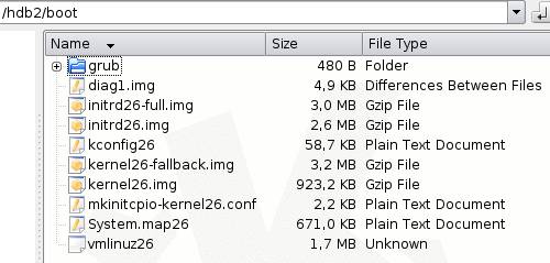

firewalker Δημοσ. 10 Σεπτεμβρίου 2006 Δημοσ. 10 Σεπτεμβρίου 2006 Λοιπόν... Στον φάκελο boot του / μου υπάρχουν τα αρχεία που φαίνονται στην παρακάτω εικόνα. Το menu.lst του grub είναι το εξής > # (0) Arch Linux title Arch Linux root (hd1,1) kernel /boot/vmlinuz26 root=/dev/hdb2 initrd /boot/initrd26.img Το mkinitcpio.conf είναι το εξής > # vim:set ft=sh # MODULES # The following modules are loaded before any boot hooks are # run. Advanced users may wish to specify all system modules # in this array. For instance: # MODULES="piix ide_disk reiserfs" MODULES="" # BINARIES # This setting includes, into the CPIO image, and additional # binaries a given user may wish. This is run first, so may # be used to override the actual binaries used in a given hook. # (Existing files are NOT overwritten is already added) # BINARIES are dependancy parsed, so you may safely ignore libraries BINARIES="" # FILES # This setting is similar to BINARIES above, however, files are added # as-is and are not parsed in anyway. This is useful for config files. # Some users may wish to include modprobe.conf for custom module options, # like so: # FILES="/etc/modprobe.conf" FILES="" # HOOKS # This is the most important setting in this file. The HOOKS control the # modules and scripts added to the image, and what happens at boot time. # Order is important, and it is recommended that you do not change the # order in which HOOKS are added. Run 'mkinitcpio -H <hook name>' for # help on a given hook. # 'base' is _required_ unless you know precisely what you are doing. # 'udev' is _required_ in order to automatically load modules # 'modload' may be used in place of 'udev', but is not recommended # 'filesystems' is _required_ unless you specify your fs modules in MODULES # Examples: # This setup specifies all modules in the MODULES setting above. # No raid, lvm, or encrypted root is needed. # HOOKS="base" # # This setup will autodetect all modules for your system and should # work as a sane default # HOOKS="base udev autodetect ide scsi sata filesystems" # # This setup will generate a 'full' image which supports most systems. # No autodetection is done. # HOOKS="base udev ide scsi sata usb filesystems" # # This setup assembles an ide raid array with an encrypted root FS. # Note: See 'mkinitcpio -H raid' for more information on raid devices. # HOOKS="base udev ide filesystems raid encrypt" # # This setup loads an LVM volume group on a usb device. # HOOKS="base udev usb filesystems lvm" HOOKS="base udev autodetect ide scsi sata filesystems" Από ότι βλέπω μόνο στο HOOKS έχει “δηλώσεις”. Μπορώ να βγάλω τα scsi και sata αφού δεν έχω τέτοιες συσκευές; Εγώ αρκεί στο menu.lst του grub να κάνω το παρακάτω; > # (0) Arch Linux title Arch Linux root (hd1,1) kernel /boot/vmlinuz26 root=/dev/hdb2 initrd /boot/initrd26.img title Arch Linux Fallback root (hd1,1) kernel /boot/vmlinuz26 root=/dev/hdb2 initrd /boot/kernel26-fallback.img
apoikos Δημοσ. 10 Σεπτεμβρίου 2006 Δημοσ. 10 Σεπτεμβρίου 2006 Από ότι βλέπω μόνο στο HOOKS έχει “δηλώσεις”. Μπορώ να βγάλω τα scsi και sata αφού δεν έχω τέτοιες συσκευές; Ναι, βγαλ'τα και θα μειωθεί και το μέγεθος του initramfs. Εγώ αρκεί στο menu.lst του grub να κάνω το παρακάτω; > # (0) Arch Linux title Arch Linux root (hd1,1) kernel /boot/vmlinuz26 root=/dev/hdb2 initrd /boot/initrd26.img title Arch Linux Fallback root (hd1,1) kernel /boot/vmlinuz26 root=/dev/hdb2 initrd /boot/kernel26-fallback.img Όχι, πρέπει να βάλεις > initrd /boot/kernel26.img Το kernel26-fallback.img είναι ένα initramfs που έχει μέσα όλα τα modules του αντίστοιχου πυρήνα, ώστε να μπορείς να το χρησιμοποιήσεις και να μπουτάρεις σε περίπτωση που κάτι πάει στραβα (π.χ. αλλάξεις hardware).
firewalker Δημοσ. 10 Σεπτεμβρίου 2006 Δημοσ. 10 Σεπτεμβρίου 2006 Λοιπόν. Το έκανα αλλά δεν είδα μεγάλες διαφορές. Αν κάποιος αλλάξει το mkinitcpio.conf αλλά δε δώσει mkinitcpio -g /boot/kernel26.img τότε οι αλλαγές είναι σαν να μην έχουν γίνει;
apoikos Δημοσ. 10 Σεπτεμβρίου 2006 Δημοσ. 10 Σεπτεμβρίου 2006 Αν κάποιος αλλάξει το mkinitcpio.conf αλλά δε δώσει mkinitcpio -g /boot/kernel26.img τότε οι αλλαγές είναι σαν να μην έχουν γίνει; Ακριβώς. Το mkinitcpio.conf καθορίζει τις παραμέτρους για τη δημιουργία του initramfs image. Αν δεν τρέξεις το mkinitcpio για να φτιάξεις νέο image, τότε προφανώς θα μείνεις με το παλιό που έχει φτιαχτεί με τις παλιές παραμέτρους.
