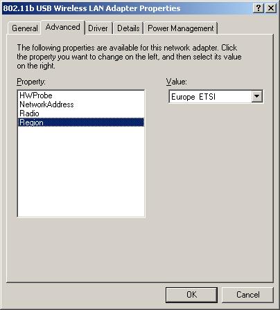

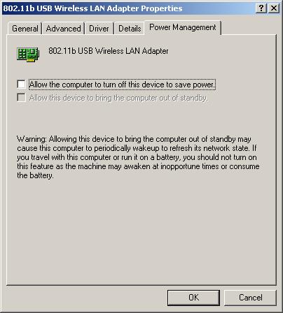

djgenesis Δημοσ. 17 Απριλίου 2006 Δημοσ. 17 Απριλίου 2006 CANtenna apo to CAN (kouti) kai Antenna To omni pros to paron den se endiaferei Pou eides to threashold ? Se poio meros ths selidas? Diladi re paidia an kataferw na ftiaxw keraioula me ton kouti tou frappe :smile: den tha xrieastei na agorasw extra exoplismo? Den mporw na sou uposxethw oti tha piaseis shma, alla exeis polu kalyterh pithanothta apo to uparxon uliko sou. Mporei sto telos ths diadhkasias na mhn doulepsei alla toulaxiston tha sou exei meinei kati (ligo parapanw empeiria apo allous, ligo parapanw gnwsh sto thema, k mia CANtenna gia thn bibliothhkh sou) Aaaaaa... kai mia gia to paron "axrhsth" wireless karta An eianie tsi thaumasia!! giati dne eiami gia na diwn extra money auton ton kairo! Anthrwpoi san kai esena brhkan aytes tis patentes, gia sena Epishs: Kane de3i click sto upologisths mou--> Idiothtes --> Yliko --> Diaxerhsh syskeywn --> (h wireless karta sou) --> kai alla3e tis idiothtes pou blepeis sto attachement opws einai (an exeis tetoies epiloges) Akoma: Mesa se ayta ta settings, an breis Antenna Power, balth sto full mode (an exei) Kai mhn 3exnas: H gnwsh einai dynamh
