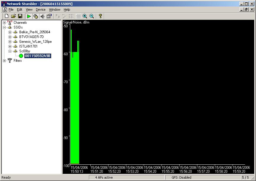

djgenesis Δημοσ. 15 Απριλίου 2006 Δημοσ. 15 Απριλίου 2006 Thelw epitelous na kataferw na mpw kai gw sto twmn alla dyskoleuomai. Ummmmm katarxhn den mas les ti problhma exeis. Den mporw na kanoume emeis to research gia to twmn (pou den h3era kai ti einai mexri na to psa3w sto google) an den mas peis pou einai to problhma. Grapse mas analytika kai kathara pou parousiazetai to problhma. Katebase kai ena NETSTUMBLER

djgenesis Δημοσ. 15 Απριλίου 2006 Δημοσ. 15 Απριλίου 2006 Katebase kai ena [b']NETSTUMBLER[/b] http://www.netstumbler.com/downloads/netstumblerinstaller_0_4_0.exe Kai des posa dBm shma pianeis. To threshold einai gyrw sta -55dBm gia ena kalo S/N ratio An den exeis kalo shma tha koita3oume allou. Metakinhse thn keraia siga siga parathrwntas thn grafikh tou NetStumbler mexri na anebei se ikanopoihtika epipeda. Bebaiwsou oti h keraia sou leitourgei se FULL operation mode (mesa apo ta settings tou Device manager twn windows)

djgenesis Δημοσ. 15 Απριλίου 2006 Δημοσ. 15 Απριλίου 2006 To S/N einai to legomeno Signal to Noise ratio kai esy pare san dedomeno oti oso megalyterh timh exei, toso kalytero einai to shma sou se sxesh me ton thorybo (noise) pou lambanei h keraia sou. Monada metrhshs ratio einai to [dBm]. Parakatw den xreiazetai na 3ereis. Sto attachement pou blepeis, exw epile3ei ena dyktio pou exw kai h grafikh deixnei thn entash kai thn poiothta tou shmatos. Egw exw internet me -60dBm kai leitourgei spasmwdika. Mia me petaei, mia me krataei. Ena "POLU KALO" shma aggizei ta -40dBm kai apo ekei kai pera paizeis. Den einai aparaithto oti ftaiei h poiothta tou shmatos sou pou den syndeesai. Mporei na einai kapoia rythmish twn windows alla einai akoma arxh kai pros to paron psaxnoume na doume ti ftaiei sthn periptwsh sou siga siga. An exeis xamhlo shma, metakinhse thn kairea sou se kapoio anoixto shmeio pou den tha exei polla pragmata (OXI pisw apo to grafeio xwmeno ston toixo) kai des an exeis kalytero shma. Meta, na metakineis thn kairea sou panw-katw/aristera-de3ia me megisth metakinhsh 6cm (toso einai peripou to mhkos kymmatos (wavelength) tou wireless sta 2.4GHz) kai koita an allazei h grafikh (H parapanw texnikh onomazetai space diversity kai to apotelesma sou e3artatai apo to eidos tou kanaliou meta3y ths keraias sou, kai ths keraias tou stathmou) Kalh tyxh
