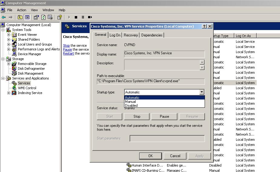

djgenesis Δημοσ. 6 Απριλίου 2006 Δημοσ. 6 Απριλίου 2006 Na to to problhma!! (kai ektos tou allou den mou exei afairesei kai to virtual drive apo to my computer-to ekana unistall apo to device manager alla sto epomeno restart na to pali) Ayto shmainei oti logw tou kakou uninstall exei meinei h yphresia tou virtual drive kai trexei akoma. Ase pou mporei na exeis kai kana allo soft pou kanei virtual drive opws to NeroVD kai na ta exei kanei sk@t@ ekei mesa. Phgaine de3i click my computer kai Manage (diaxeirhsh) Phgaine stis yphresies kai efarmoges kai bres to service tou alcohol Pata diakoph ergasias (STOP) kai meta apo to drop down menu epele3e typos ekkinhses mh energh (opws sto synnhmeno) Eidallws: Pata start--> Run kai grapse msconfig Phgaine sta services kai bres to service tou alcohol. 3etickare to kai kane restart. Prospathhse na to 3anakaneis install Pes mas ti egine
