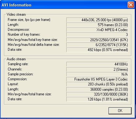

FILIM0N Δημοσ. 25 Μαρτίου 2006 Δημοσ. 25 Μαρτίου 2006 Afou den ebgala akrh eipa na grapsw. Exw 2 diaforetika avi kai prospa8w na ta enwsw. To virtualdub bgainei apeksw afou exoun diaforetika video streams. Epixeirhsa me to Nerovision alla dustuxws kollaei sunexeia se ena sugkekrimeno shmeio tou 2ou video. Pws mporw na ta enwsw, giati mou xei faei wres h olh istoria?

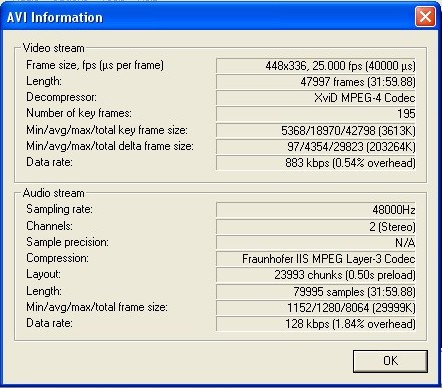

FILIM0N Δημοσ. 25 Μαρτίου 2006 Μέλος Δημοσ. 25 Μαρτίου 2006 Telika katafera na ta ferw sto idio forma, alla exw prob me ta audio streams. To ena einai sta 44100 Hz kai to allo (to megalo) sta 48000 Hz. Kapoia lush?
cybereddie Δημοσ. 25 Μαρτίου 2006 Δημοσ. 25 Μαρτίου 2006 just load avi 1 into VirtualDUB, set video to Direct Stream Copy and Audio to Full Processing Mode and set audio compression to "No Compression (PCM)", then hit Save AVI. Do the same to 2nd avi then you will be able to merge them.
FILIM0N Δημοσ. 25 Μαρτίου 2006 Μέλος Δημοσ. 25 Μαρτίου 2006 Euxaristw gia thn apanthsh. Dustuxws de lu8hke to problhma. Eksakolou8ei na bgazei to idio mhnuma gia ta audio streams (to opoio omws den einai logiko...). Akoma omws kai na douleue, diplasiasthke to mege8os twn arxeiwn kati pou de 8elw. Den uparxei enas aplos tropos metatrophs tou 1ou arxeiou apo 44100 se 48000 Hz? Giati telika ekei kollaei to olo 8ema. Dokimasa to virtualdub alla o monos codec pou to kanei einai o windows media audio, o opoios leei den einai egkatesthmenos...
