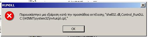

lefkas Δημοσ. 22 Νοεμβρίου 2005 Δημοσ. 22 Νοεμβρίου 2005 Gia sas, Exw ena mixanima me win2000 Pro (SP4). To mixanima einai psagmeno kai katharo apo Ious.Ola kala ola antihra, alla den mporei na anoiksei ton control panel(!!!!).Pio sigkekrimena emfanizei to akoloutho minima (attached file) Kserei kaneis pou mporei na ofeiletai auto?

or1onas Δημοσ. 22 Νοεμβρίου 2005 Δημοσ. 22 Νοεμβρίου 2005 Episis, twra mou hr8e sto myalo kati pou eixa pa8ei paliotera k gw: Eixa corrupted ena .cpl arxeio (auta einai ta arxeia pou antistoixoun sta tools tou control panel). Kane loipon ena search sto drive twn windows gia .cpl arxeia k prospa8hse na ta anoixeis ena-ena. Isws kapoio apo auta na einai corrupt k na skasei. An ontws isxyei auto, 8a prepei na kaneis recover to arxeio apo to cd twn windows...

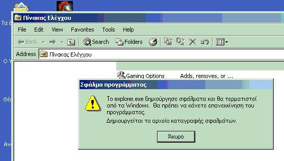

lefkas Δημοσ. 23 Νοεμβρίου 2005 Μέλος Δημοσ. 23 Νοεμβρίου 2005 Kalimera, Ekana auto me ta .cpl files, vrika ena (see photo). Den dokimasa na to antigrapsw giati den eixa eukairo CD win 2000, kai ta monadika mixanakia pou vrika me win2000 exoun tin Aggliki version (Se antithesi ame auto pou exei tin Elliniki), opote eipa na min riskarw. Kai ekei pou eixa skopo na to kanw aurio - methautio, eida oti mou emfanizei to idio minima kai otan paw na kanw paste fotos sto Word (kata ta alla to word paizei OK). Episeis, paizomntas me ta cpl files, mpika kapoia stigmi sto add/remove programms. Ekei eida kati pou den fantazeste. Tin Arta k ta Giannena (xwris pareksigisi gia tou katoikous ton omorfwn autwn polewn) eixe ekei. Lamvanontas eip opsin ola ta parapanw, to mixanaki paei gia format.... Euxaristw pantws P.S. MAGELIS Den dokimasa na to anoiksw se mikro parathiro, isws to kanw aurio (to pc einai se allo ktirio-pou na pigainw pali ekei). Tha sou pw otan to koitaksw.
